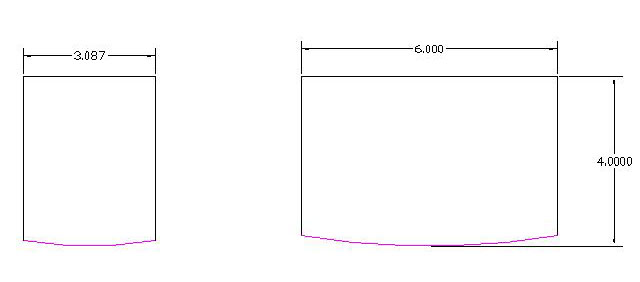

Ok the earlier discussion on radiusing jigs got me going. I've not wanted to build one until I could incorporate a compound radius set up.
While this is not complete and is UNTESTED, it's pretty close so have a look, and fire away. Let me know what you think. Good or bad.
Looks huge here but it's only 44" long
This is what the radius blocks look like. A 16" on one end and a 20" on the other and I should have the fabled compound radius.
This is the part still to be finished. The sled. Not real sure what I want here. I'd like to incorporate dust collection, but I'm still thinkin.
Thanx for looking. It'll be awhile befor I can really test this on anything but scrap. I still need to build a jig for using Shane's fret slotting blade. Lots of work before the next batch of fingerboardsare ready.RCoates38810.0045949074

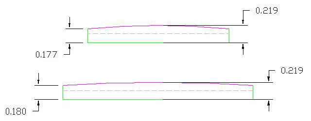

Just an observation and mybe you have it covered, but when cutting a compound the position pf the radius guides for the side bars is critical in order to achieve the correct compound.
To give an example if I want to cut a compound that goes from 12 at the nut to 20 at the bridge. You need the first guide level withy the zero fret position and either a 20 at the saddle position or a 16 at the mid point of the saddle and the 12th fret.
Maybe you have this worked out with the maths on your guides ?, but of course these positions change with each new scale length.

Besides the comments about the radius values at the actual end supports (e.g. if you want a 12"-20" compound radius on the fingerboard, you may need something like 8" and 24" for the radius guides), also make sure you set the height of each radius guide so that the edge of the fingerboard remains the same thickness at the 0th and 22nd frets.
Since the difference in thickness between crown and the two edges (that is, the 1st and 6th strings) will be less at the end with the higher radius, you will end up with the 22nd fret end of the fingerboard being thicker on edge if you don't compensate. This would typically happen if you adjust the heights of the two radius guides such that the router bit just "kisses" the crown of the fingerboard along it's length.Pete Licis38810.5143634259

[QUOTE=Pete Licis] Besides the comments about the radius values at the actual end supports (e.g. if you want a 12"-20" compound radius on the fingerboard, you may need something like 8" and 24" for the radius guides), also make sure you set the height of each radius guide so that the edge of the fingerboard remains the same thickness at the 0th and 22nd frets.
Since the difference in thickness between crown and the two edges (that is, the 1st and 6th strings) will be less at the end with the higher radius, you will end up with the 22nd fret end of the fingerboard being thicker on edge if you don't compensate. This would typically happen if you adjust the heights of the two radius guides such that the router bit just "kisses" the crown of the fingerboard along it's length.[/QUOTE]
When I first read what you said - the edge of the fingerboard should remain the same thickness , I thought "no - you want the center thickness to be the same at both ends".
But, I think the real answer is that you want both of these to be true. The fingerboard edge thickness should be constant AND the center thickness should be constant.
Isn't that what the compound radius accomplishes? That way, the fingerboard thickness is constant under each string for the whole length of the fingerboard.
If you had a constant radius fingerboard, either the center would be thicker at the wide end, or the edge would be thinner at the wide end. The compound radius (larger radius at the wide end of the fingerboard) should mean that the center-to-edge difference is the same at both ends of the fingerboard.

THe heights of the radius blocks can be adjusted. The "keyway that they fit into has a separate block down inside that is loose. It sits ontop of the center block of the three blocks that make up the end of the jig. Clear as mud??? it's visible slightly in one pic.
The height of the cutter above or below the level of the radius block will affect the radius that is cut. That's pretty easy to deal with. The blocks are cut at a slightly larger radius than desired. based one the guide bars distance apart (8")I cut the blocks at 16.5". The difference is really abot 13/32" but who's counting?
That should theoretically, give a radius pretty close to 16". The problem is that, just as Russell and Pete said, the distance of the radius blocks (register points for the guide bars) away from the location where either end of the fingerboard is placed for cutting will also affect the radius that is cut. Move the FB back or forth and that affects it also. Change the scale length and that also changes it(although not much).
So lot's more math to do to get it just right. It's been a few years since college so anyone that crunches numbers with some frequency, please feel free to chime in.

I'm having trouble understanding how this jig creates a compound radius.   I haven't studied it real close but wouldn't the bit be traveling in the same radius from one end to the other? I understand that the end guides that the two tubes rest on are different radii.
What am I missing?

That is in fact how it works. Take a look at mine. It works on the same priciple but it swings instead of rocking.
The advantage of Craigs design is you can interchange different radius patterns. I figured I would just decide on one and stick with it.

John--I understand how yours works but it looks to me, on Ron's jig, that the router bit is going to be traveling in the same arc regardless of where along the slide the carriage is positioned.
I looks like the effective radius, which I don't see as being compound,is a combination of the two different templates. Not sure how you would calculate this "effective" radius though.
Nelson
PostPosted: Tue Apr 04, 2006 3:14 am
The parrallel bars follow a different radius on each end so as you move the router from one end to the other, the radius gets smaller or larger.
It does work.
Phil[/QUOTE]
Well, yes and no. Or perhaps I should say to some extent. in order to keep a constant fingerboard thickness down the crown, as well as a constant edge thickness along the length, the difference in radii would have to work together with the fingerboard taper.
For example, say you wanted a fingerboard radius of 10" at the nut, and 20" at the other end (numbers chosen for simplicity). In order to do that, and maintain the constant crown/edge thickness, both ends of the fingerboard would have to subtend the same arc in degrees, meaning that the far end of the fingerboard would have to be twice as wide as at the nut. So, for a 1-3/4" nut, the other end of the board would have to be 3.5" wide ... not likely to happen!
Since the fingerboard taper remains more orthodox, you'd have to choose different radii that work out better. As another example, if you have a nut of 1-3/4 and 21st fret of 2-1/4 (more reasonable?), then radii of say 14" and 18" would work. I think most people want a little more delta in there, which means that you won't have constant thickness at the crown, or at the edges, or both.
Since a change in edge thickness may be noticable, I personally would prefer to let the crown thickness vary a little from end to end.
The above is all strictly mathematical. In reality, it doesn't matter all that much it turns out. I had done a quick calculation for the instrument I'm currently working on, and as it turns out, I did go with a constant crown thickness (contrary to what I suggested previously)- whadda ya' know! I used a 10" and 18" radius and widths of just over 1-3/4 at the nut, and about 2.4 at the 21st fret. The edge thickness did vary, but with this combination, not by much, as you can see in the drawing below which I copied from my design drawing.
The three thousandths variation in edge thickness can't be visually discerned over the 18" of the fingerboard.

That got me to thinking there could be more potential problems regarding getting an accurate compound radius with this jig. Quite a while ago I had worked out all sorts of potential designs for such a jig, and as the cobwebs cleared somewhat from my memory, the following complication came back to me. (This may or may not clear up any confusion, and it could potentially add more!)
For the jig to work "right", you'd have to abide by the same principle of subtending the same arc on both ends of the jig. So, the radius guide at the end with the higher radius would have to be much longer (over twice, depending on radii) than the one at the nut end. Below is a drawing of what I used for a jig similar in principal, but very different in operation (10" and 18" radii).
Basically, during operation of Ronn's jig, you can think of it in this way. When you move the rails over the radius guides, at any one time you want both ends of the jig to maintain the same tilt angle off horizontal. Picture starting with both ends at no tilt (router at top dead center of each radius guide). As you move off the crown of the radius guide to the maximum tilt of the router/rails on the nut side (say 20 degrees hypothetically), you'd also want the other end of the rails to be tilted 20 degrees, or else you'd have twisting and racking of the rail system. Once the guides do subtend the same angle on both ends (with the guide for the larger radius approptiately longer), at any one time, the position of the rail system on each guide would have to match on both ends in terms of % of maximum. So both would have to be at 0% (top dead center) at the same time, both would have to be at +50%, both at -70% and so on. If you haven't caught on, that means that the rails on the end with the larger radius would have to be moved a lot more linear inches across the radius guide for a given movement on the end with the lesser radius.
Clearer than mud, no?
In answer to Nelson's question, as the router is positioned toward the nut end on the rail system, it will sweep a tighter radius than when positioned on the other end, given that the conditions I just described are true.
What if those conditions are not met - and the jig is used as is and without regard to the % relative motion?? I dunno. Perhaps the result is not enough of a difference to be noticed on the fingerboard, or perhaps you'll see very noticable gaps as you hold a straightedge against the board in line with the different strings. Easy answer of course, would be ... try it!
